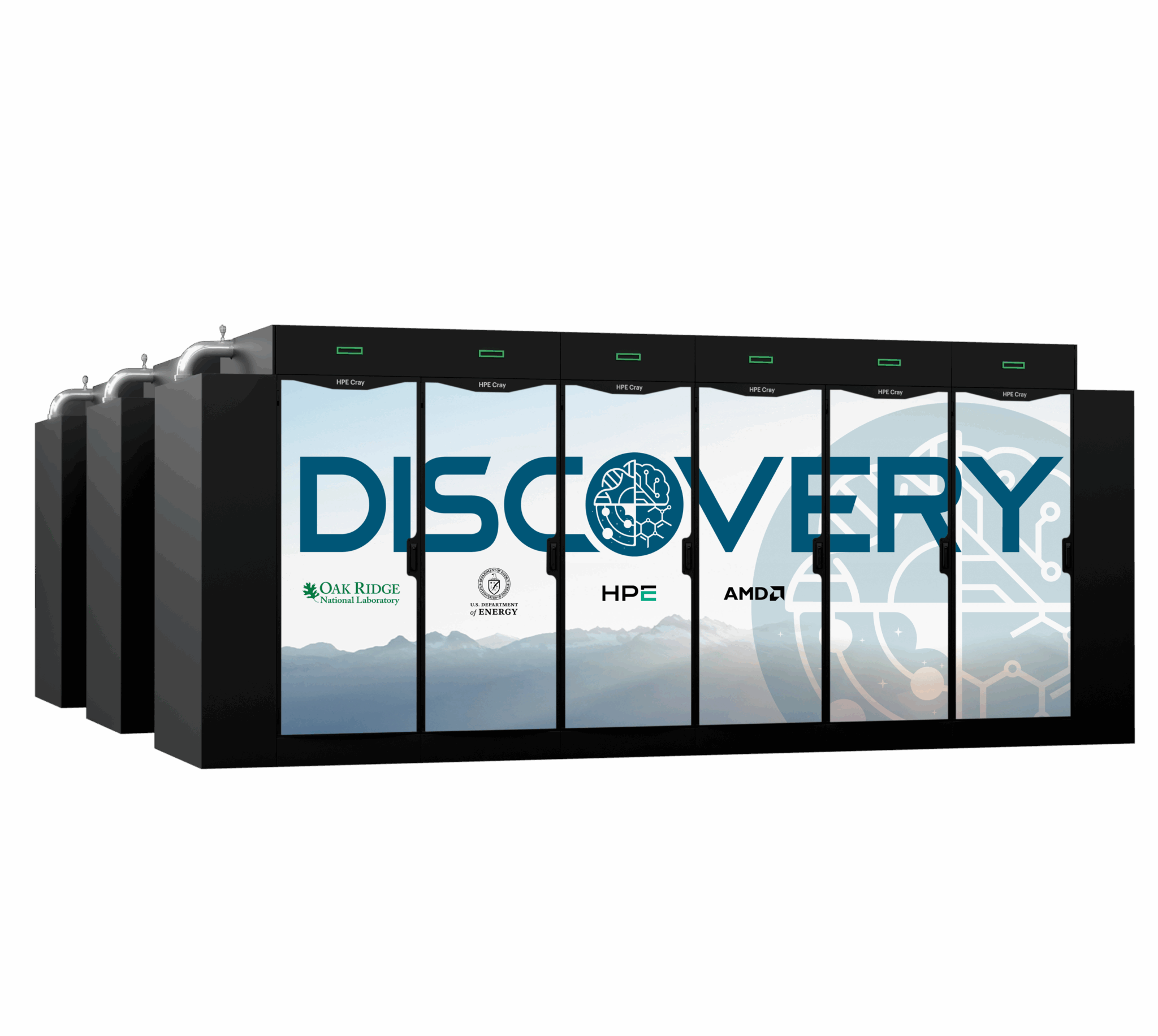

Blog: AMD Instinct MI430X: Powering the Next Wave of AI and Scientific Discovery
Instinct MI430x in Kombination mit EPYC Venice für Supercomputer angekündigt:
Norrod:
Lisa showed the first silicon, we are right on track with where we thought we would be, both in terms of the readiness of the overall solution as well as the readiness of the silicon. And we are highly confident of ramping Helios in high volume in the second half of the year.
